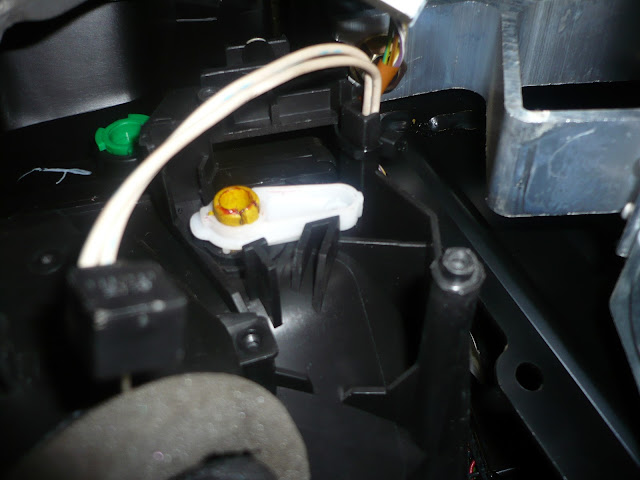

Mimmi kirjoitti:Do you have ventilated seats? Ventilation is suck, not blow.
If you have cold blow to your legs, driver airbag needs insulation on backside.
No i dont have ventilated seats.
I open the area by following http://photo.platonoff.com/Auto/2009101 ... epair/?all
And i noticed that the plastic part has been replaced before already. As you can see in this picture its the white one. This is from a saab service kit.
http://lh3.ggpht.com/_8tXqdSrL-is/S2mpQ ... 100094.JPG
I noticed that turning the white thing around while the engine is running doesnt change the heat. So i fear that its broken inside... (It also feels very loose)
I ran the calibration ones again with the motor not attached. And the steppermotor is running fine. (It shows then 1 08 )
With the motor in place it shows 0 (no errors).
Any tips?

ok i found the problem.
its like in this picture
