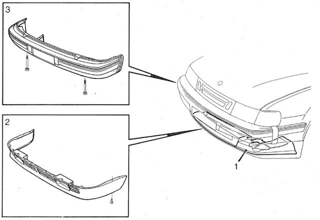

Bumpers,front removal and installation
1 Remove the outer shield and the central shield under the car.
2 Unscrew the temperature sensor and insert through the orifice spoiler. Then remove the screws that hold the spoiler.
3 Remove the two screws holding it and lift the bumper.
When mounting the bumper, the grooves of the outer casing must adapt to the wings tongues before. First of all mount the outside shield, insert the bottom tab on the front edge of the inner wing. Install screws loosely. Insert the clip of the central shield on the support frame. Install screws loosely. Adjust shields and tighten all screws.

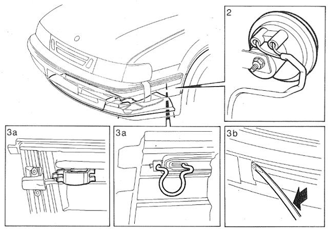

Trim strip, front bumper
Disassembly and assembly
1 Remove outer shield left or right in order to make accessible the tension spring of the trim strip. 2 Relates to the left: Remove the horn of the mounting bracket.
3 Remove the trim strip as follows:
a. Release the tension spring of the trim strip.
b. Insert a screwdriver and unhook the claw that holds the tape trim to the bumper.
Assembly is done in reverse order.

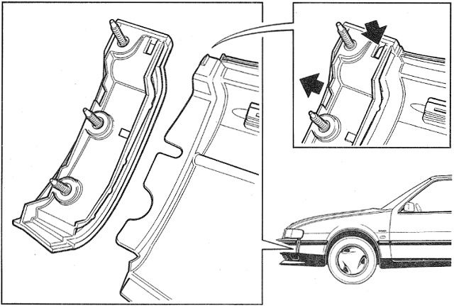

bumper housing SAAB 9000 CS
To ensure the adjustment of the bumper of the front housing with respect to the bodywork, there is a locking lug (1) on the ends of the housing. These locking heel lock on the housing side spoilers. When the bumper housing must be reassembled, the locking heels must be unlocked side spoilers with a screwdriver or similar.

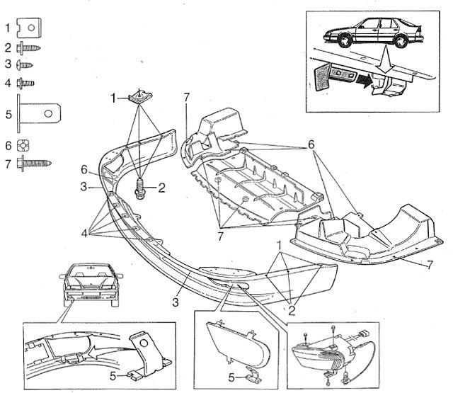

Front spoiler and air shields, Saab 9000 CS
1 Clips (6)
2 screws (6)
3 screws (2)
4 M4 screws (5)
5 Clips (2)
6 Clips (4)
7 M6 screws (14)
The front spoiler and air shields are mounted as shown in the figure.
1 Clips (6)
2 screws (6)
3 screws (2)
4 M4 screws (5)
5 Clips (2)
6 Clips (4)
7 M6 screws (14)
