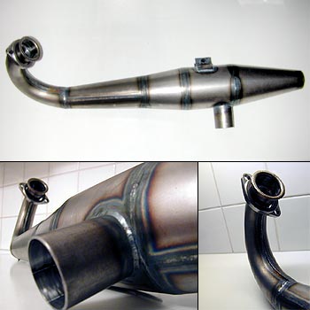

tuosta skaalailla mittasuhteilla tehoputki:
Bolt-on and made for the 2" exhaust pipe. Gives the best average power between 2000-6000rpm on a gr.II tuned engine. Gives a marked increase in torqe. +5-7 hp on a standard engine. Always upjet 2 steps.
https://www.classicsaabracing.com/en/xp-tuned-pipe
